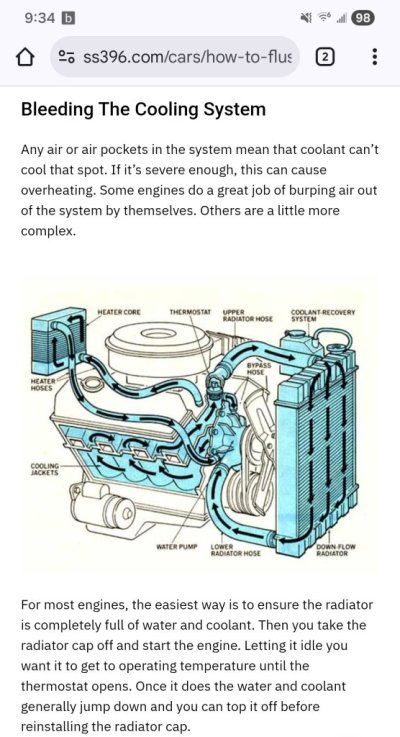

I found his online it might help. Old school way was to remove radiator cap and let the engine idle until the thermostat opens, then add coolant until it refills. Most of the air will bubble out.

Thanks guys, but my problem is there is no cap on the radiator it’s on the over flow which is up on the firewall on the passenger side of the engine compartment . So I should still open cap and let it idle ?
