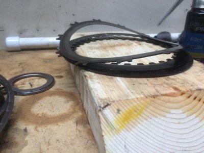

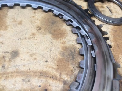

When you manually downshift, the transmission will be in 3rd (5 speed) or 4th (6 speed) gear before you go WOT; when you let it manually downshift you're already at WOT before the computer tells the transmission to downshift from 5th to 4th to 3rd (5 speed) or 6th to 5th to 4th (6 speed). The reason WOT is the issue is the transmission is trying to transfer the torque from the engine through the 2C clutch pack in 4th/5th which doesn't have the same holding capacity as the other clutch packs and any amount of slipping will glaze the clutches.
When you really romp on it with some power you can do some amazing things to the internals, see my pics below.
