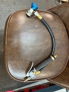

Thank you so much for the awesome write up! I had the exact same problem and a new valve block solved it- found a new one on Amazon for $50. Also wanted to add- my Harbor Freight tire inflator screwed right into the low-side AC fitting off of a manifold set, from HF as well. Thanks again!
