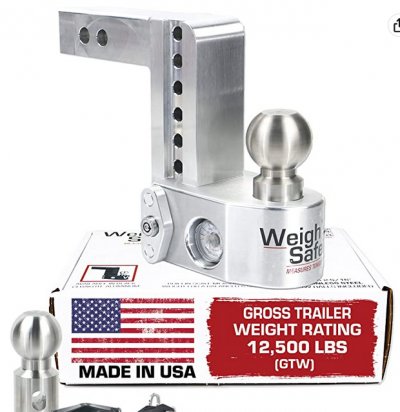

For just a normal ball, not weight hitch, pick up a weigh safe with internal scale on the hitch so you know what you your htonugue is for the tiem beign towed. get whatever length drop you need and adjust ball position based on trailer being connected to truck.
scale right inside the hitch.
Length of the drop shaft allows you to swtich up ball hieght. also, ball is completely interchanging with a ball of different size.
easy peasy to tow whatever, whenever.

I am most definitely going with the Weigh Safe Hitch. Given my newness to this situation, I think the Weigh Safe takes the guess work out and relies on formulas. My undergrad is in Physics and the Weigh Safe seems perfect - IMO - compared to other systems. JIC, I understand math more than towing currently.
I'm getting the B&W Chrome 3 Ball Drop Hitch for non-tailer pulling. It gives me my weight rating, all towing possibilities, and looks nice, IMO. If I can buy a ball from Weigh Safe to fit the WDH and its not close in price to the B&W - I will get that.
