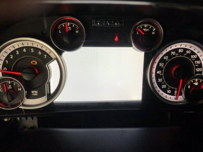

2014 Ram with the base cluster. I got a 2014 premium cluster and switched them. For some reason the big screen on the new cluster is white. All the manual gauges work. Is the cluster bad?
Sounds like it. Can you post a picture? Does anything on the screen change?
