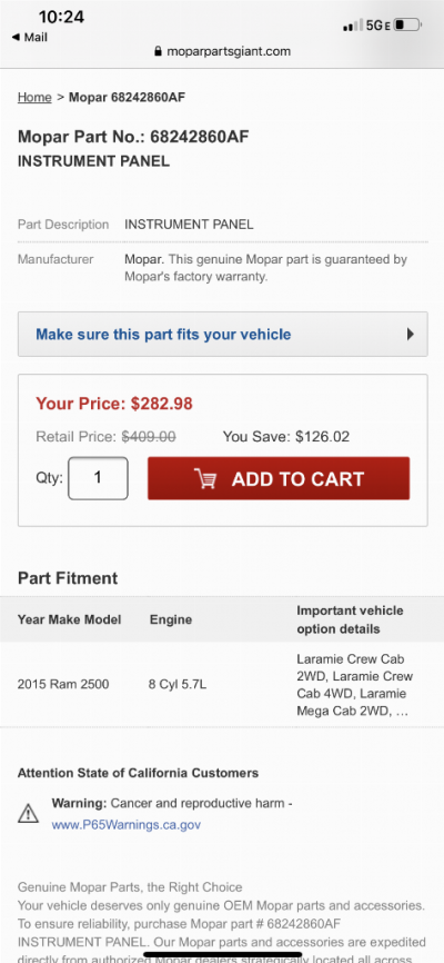

This one?
P68242860AC

Thanks so much for the help. I just seen I had one number wrong, so sorry.
P68242850AC

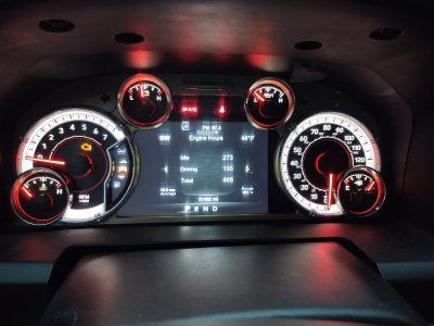

Everything arrived and installed today! Love the way it looks!

Thanks to everyone for the help, and for this great thread explaining the install!!
