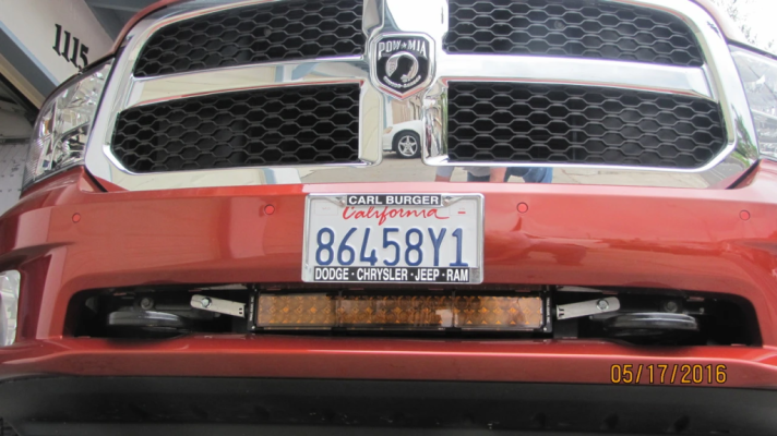

body shop put my tow hooks on backwards
The open part of of the hooks should face outwards

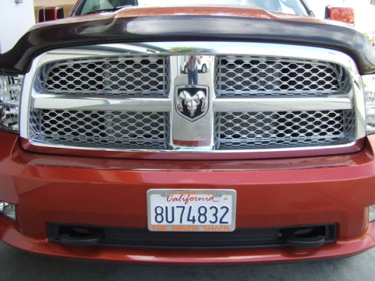

This is my 2016
on my 2009, i did not need the fog light bar
so the bumper bezel had to be modified

I may be wrong, but to me, the hooks are on backwards

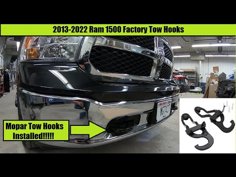

This guy installed the tow hooks on a Gen 4 Ram with the Sport bumpers.
He installed the hooks the way they should be, to my way of thinking.
He cut the plastic insert to fit over the tow hooks
