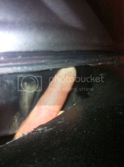

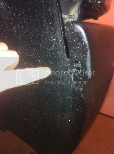

Here is a quick wright up on the easy way to adjust JJ heads in a 2nd gen ram WITHOUT taking the dam light completely out to do so .
Its simple ..
On each side of the fender wells in the front right behind the light you will snap the splash guard off ... behind it you can take a little screw driver and adjust .. or in most cases use your finger. Stick your hand up there and adjust .
The screw .. only one ...
Beats taking them lights out every time .

and this will work with any of the same style lights (not just mine) - goofy design!
Thanks for the pics Dave!
