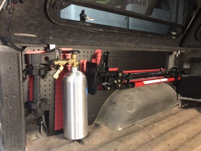

So I'm starting a project. I want to increase the utility off my bed by adding some bedside racks to the inside walls. I want to be able to mount a shovel, axe and other things in there under my tonneau cover to keep in there all the time. My plan is to use 1/2" HDPE and cut out holes in a molle pattern so I can use molle pouches or also mount quickfists for handled tools. I'm planning on using rivet nuts to attach it around the perimeter and I have a nylon cylinder with a 1" diameter that I'll use as standoffs at varying depths because the side of the bed has different depths in different places.
The piece of HDPE that I have is 24"x 48" so that's why it's not running the entire length of the bed. Which I'm fine with because the head of my shovel can hang off the end and that part of the rack is hard to access anyway.
I'm also planning to incorporate some bed lighting under the rail after the rack is in.
Let me know your thoughts! Any ideas or advice would be welcome. I'll keep posting and keep this thread updated as I make progress on the project.

Ok I finally got around to finishing this project!

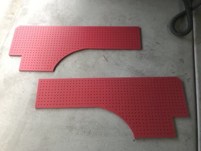

Transferring the template to the HDPE
Cutting it out with a jigsaw
Drilling the mounting holes
I did some experimenting with a molle pattern but because the material is so thick it's not going to work for a lot of pouches since they're designed to work on the thickness of nylon webbing. I'm glad I did some experimenting because it would have been a lot harder to cut a molle pattern and it wouldn't have even been useful!
I decided to just do round holes. This is a 1" grid I printed off to use as a guide
Used a center punch to start all the holes and to transfer the pattern onto the panel
Drilling the holes. Over 500 of them... I'm glad I have drill press. The ones it couldn't reach I just finished up with a cordless drill.
Ok, now the part where there's no turning back. Drilling into the bed of your truck. After using shims etc. to get the panel placed where I wanted it, I used a punch through the mounting holes to mark where to drill. Then, using a step bit, I drilled holes that were 11/32" wide which was perfect for the rivnuts I have. They need to be nice and snug to work correctly.

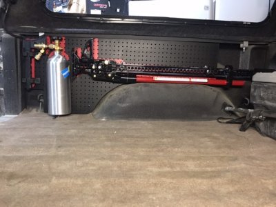

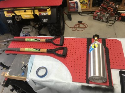

Now the fun part. I placed the tools where I wanted them and mounted the quickfists.
All mounted up!
I'm pretty happy with how it turned out. I'm still planning to mount a pouch in that leftover area for ratchet straps etc. So that is still to come.
