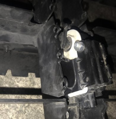

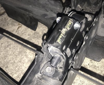

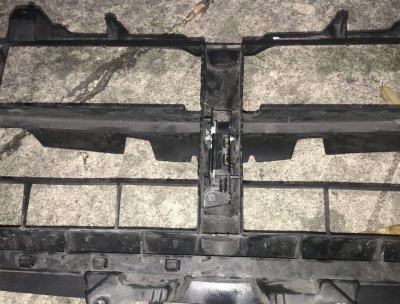

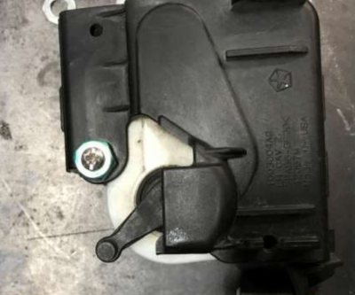

I then deleted the Active Grill Shutters. Not the whole unit, just the shutters. It seemed like a pretty nice bezel that seems to do a good job of funneling air into the radiator, so why not? This was pretty easy, take out the bezel, remove the shutters and the motor. Then drill 1/8" hole and install a 1.5 x 1/8" bolt with an extra nut and some washers as a spacer into the motor to fool the truck into thinking everything is still functioning correctly. Then put the motor back into the bezel. (Less than $2 at Home Depot)

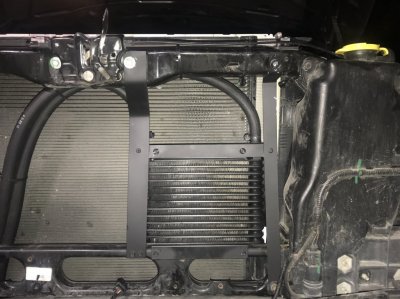

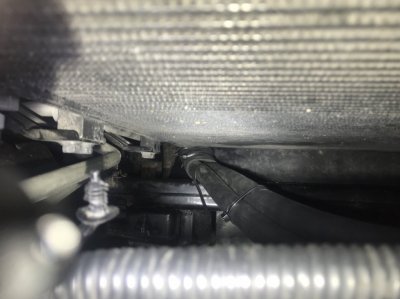

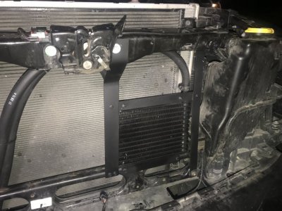

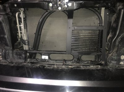

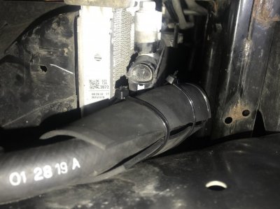

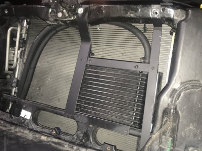

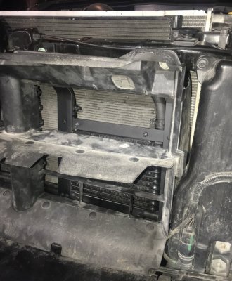

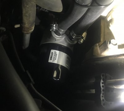

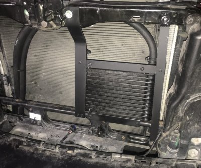

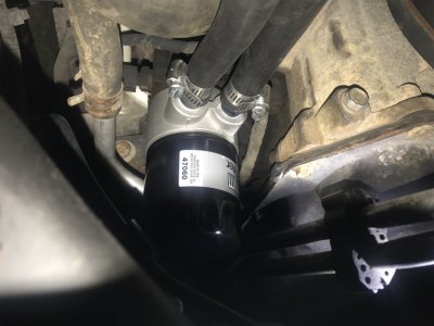

Next I installed a Derale 15405 Engine Oil Cooler Kit ($113.99 on Amazon w/Prime). This kit comes with pretty good instructions and claims it can reduce engine temps by 50° and is good for something like 40,000 BTU worth of cooling. I chose to fab a custom bracket using flat aluminum bar stock bent to mount the radiator using 3 factory mounting points and a few other self tapping screws. See pictures below.
Total install time took about 4 hours including fab time and waiting for the paint to semi-dry. I did an oil change at the same time with Mobil 1 full synthetic (factory weight) and a Napa Platinum oil filter. It took about 1qt above the factory 7qts.

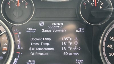

Results were amazing. Oil and coolant never top 186° driving around town. I am seeing right at a 39° decrease in operating temps. Zero check engine lights after almost 400 miles. Truck runs flawlessly. I have yet to tow, however I am confident results will be on par with what I am already experiencing. I'll update after the 4th with actual results.

Towed the trailer (34’ 7600lbs) today for several hours in mixed traffic. Ambient temp was around 95. Coolant never got above 195. Oil temp peaked at 204 during stop and go traffic on the highway. During regular driving it hovered around 198. This is down from 250-260. MPG seems to have a slight increase, too. I would call this a giant win.

Did you have any issues with the oil filter fit-up or did you have to use a different oil filter moving forward? Do you happen to remember which sleeve nut you used?
I am considering Derale 15605, which is a similar kit but may have a thermostat in the sandwich plate (at least it has the same "sandwich adapter type A").
Edit: After finding instructions, I assume you used the green sleeve nut (22mmX1.5mm) & I see you used a standard Wix 47060 Filter, which fits the stock engine - what is interesting is that the instructions for the kit you used states it is for engines with oil filter landings ranging from 2.75"-3.50" but the Wix 47060 has a gasket of 2.42" ID x 2.758" OD
