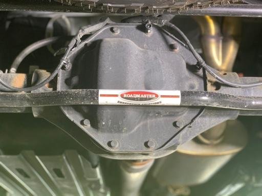

2. Remove the 3 plastic clips that are routing wires around the top of the direction. I used a flat head to remove them. Tuck the wires on the otherwise of the diff.
3. Remove the 4 bolts holding the sway bar to the axle and slowly lower it down. This will allow you clearance when removing the stock cover and installing the PML cover.

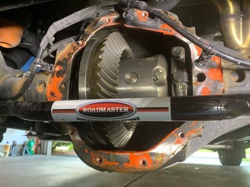

7. Now the fun part starts, using a razor blade start scraping off all the orange RTV on the diff housing. Take your time doing this. You want to make sure the surface is perfectly smooth so the new gasket seats cleanly against it.
8. Find the three double threaded bolts. You will need to reuse these so you have a spot to reattached those wires. If you do not remember which holes those screws go in refer to my picture above.

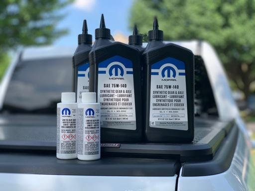

1. Before starting this project make sure you look in your manual and very the correct oil based on your rear gear ratio.
- 3.21 and 3.55: This gear ratio requires 75W-90 (MS-A0160). 3 quarts for the PML capacity.
- 3.92 (Rebels): This gear ratio requires 75W-140 (MS-8985). 3 quarts for the PML capacity.
- All the rear-ends require 5+ oz. of Mopar Limited Split Additive (MS-10111). You will need to buy two bottles of this since with the PML cover you will need ~6 oz.

12. Remove both the fill plug and the dip stick plug. Using the following fill sequence to help with initial mixing of oil and additive.
a. Pour in 1 qt of oil.
b. Pour in ¾ bottle of additive.
c. Pour in second qt. of oil.
d. Pour in remaining additive to equate to ~ 6 oz.
e. Top of with rest of oil until oil starts to come out of the dipstick plug.
