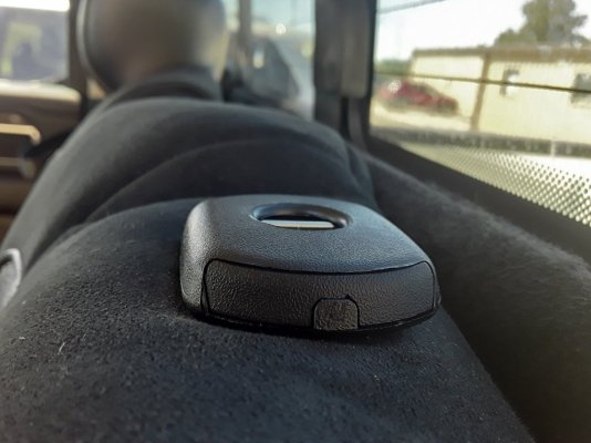

Ok. I tried again to REMOVE the head rests and still couldnt get them out.
After looking at the owners manual it says, "Outboard head restraints are non-adjustable, but can be folded down for visibility."
Also, "If any head restraints require removal, see and authorized dealer."
I dont want to simply fold them down. I want them out, removed, gone, disbanded, fired, finished... you get the idea.
I see tabs on the right side of each post, where the head rest connects to the seat, but the tabs dont push in at all. They are flush already. Im going to try again, and hold my mouth a little different this time. I bet that will work.
EDIT: You will need a small screwdriver or something to push in the small tabs. You will never push them in far enough without some kind of tool. See picture below.

crazy I just used my fingers. I don't run with head rests in the back either.

Yall must have fingers the size of paper clips. Lol
On the 1500 I had to push in the tiny tab inside the larger one. The larger tab doesnt move at all.

must be different on 1500's, your photo looks the same as mine but on mine the little tab stays put and the larger tab pushes in.
