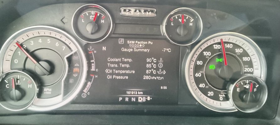

220-225 is normal on the Pentastar, especially at idle when the air flow isn't being forced through the radiator. They are designed to run that temp and the cooling fan typically won't cycle on before that (it will when certain variables are met, e.g. A/C and ambient temps meet threshold for fan activation). I'm currently sitting at 4 degrees and my truck will run all the way up to 223 prior to the fan cycling on, sitting idle. Pis ses me off, but that's the way it's designed. I have wired in an aux. cooling fan for times when I'm sitting idle or moving slowly under load (offroad in the mountains) that I can turn on with an old fashioned rocker switch. It's not glamorous but it's what I've done to keep operating temps down at low/no speed because 223 pis ses me off. While moving at a steady highway speed the truck runs consistent 198-203 and will spike to 205-207 if I start pulling a small grade and the RPMs are up a bit. I run 220-225 when pulling mountain grades and RPMs are in the 3500-4000 range. Might be useful info for you, might not be.

I have one, but I’ve found that there are at least 3 vac lines into the intake. So it’s still in a box in the garage. The lines are also annoying hardish plastic.
For now I’ve wrapped a battery blanket around the throttle body, which I only plug in below -30.
These are normal running temperatures pretty much all year. They only jump when I’m towing or climbing a long hill.
Can't read that gauge cluster...seems to be in a foreign language :hahano:
