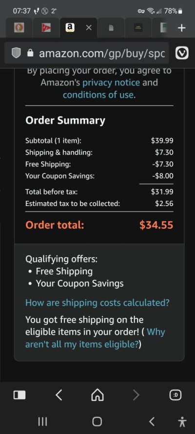

If you require 9005 bulbs and have a US address, Amazon.com has a sale on the 2-pak.
I live close to the border and use Myusaddress.ca to receive packages in NY.
Ignore the Amazon fitment guide that says they don't fit. I have a set installed in my '21 Classic.
Be sure to clip the 20% off coupon, your check-out price should look like this.
And for those US residents considering to purchase LED lighting, this might be a good time if these bulbs fit your truck.

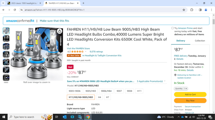

I purchased these ones from their Canadian site.
Thanks.
I bought that same kit from Amazon.com last May.
For some odd reason, when you buy the 9005s in a 2-pak in Canada, they're 9K lumens but 10K lumens in the US.
Unless you hunt and then you can find them at 10K lumens in Canada in a 2-pak.
I'm currently negotiating with Fahren to replace my pair of 9K lumen 9005s.
Ten emails later and they finally understand what I'm looking for. :cool:

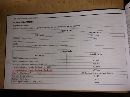

If the truck takes 9005 and h11s it has reflector headlights. If it takes two sets of 9005 it has projector headlights. There are no premium projectors it's one or the other. So your truck has projectors not reflector headlights.
Thanks for the clarification and thanks for rescuing me from the Ram scam.
I wasn't certain which headlights my truck used; my only information source was the user manual.
