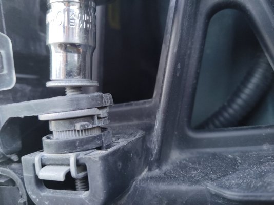

I blame you guys and this thread for this happening :rolleyes: Needless to say, both stock low beam bulbs are back in.
And a reminder that the metal ring with tab is left hand thread and will back out as you tighten the bolt down.
Also found that, although the passenger side low beam clicks in at 90*, the drivers side does not. I don't remember if I clocked the LED correctly when I tried them. But it's supposed to get cold and miserable next week and I'm not taking it back apart to test.

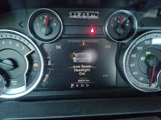

Fair enough.
What lights caused the issue what is low or high beam? Anything we can take away?
Hopefully a solution to assist can come from it . As I know I started the thread mainly due to my halogen bulb in one housing
And yeah lucky enough no clips busted !!
RamDiver
Jan 23, 2022
5,818
12,301
Marlborough, Ontario Canada
2021 DS
Stock 9005 SI+. It was quickly approaching dark:30 and I wasn’t about to play ‘find the 10mm that you dropped under the truck’. At least it died on my last day off… it’s supposed to be -20 and colder next week.
