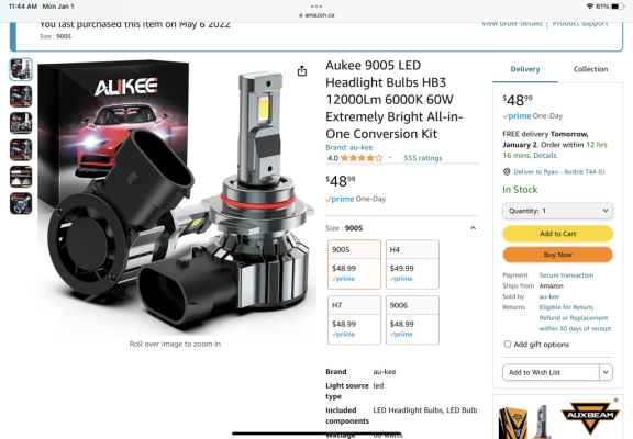

I recently installed Fahren LED lights in my '21 Classic. They were completely plug n play with no configuration changes required.
I should also mention that I think they're fantastic and tough to beat for the price. I chose these lights because of the success stories that I have read hear on Ram Forum.
The high beam lights are spectacular and cast a bright light far down the highway, black & white compared to halogen.
The low beam lights are far brighter than the halogen but don't seem to be quite as bright as the high beam lights with a lower beam angle.
The road is still lit enough enough that I can drive on rural highways while wearing yellow lenses and not overdrive the lights on low beam with the addition of driving lights. (Ram calls them LED fog lights but they're white driving lights).
I have observed no flickering or other undesirable effects . The lights fit inside the housings with the covers on.
My truck has Premium Projectors and uses 4x 9005 bulbs for both the low & high beam.
I had originally purchased the wrong bulbs, thinking that I had the basic Projectors which for my truck is 2 H11s for low and 2 9005s for high beams.
If you use this link and just below the center of the Amazon page, select the 9005 option, you will see the bulbs are rated at 10,000 lumens each instead of the upper Amazon link where they're 9000 lumen per bulb.
Amazon.com lists the 10,000 lumens version of the 9005 bulb but .ca has it somewhat hidden.

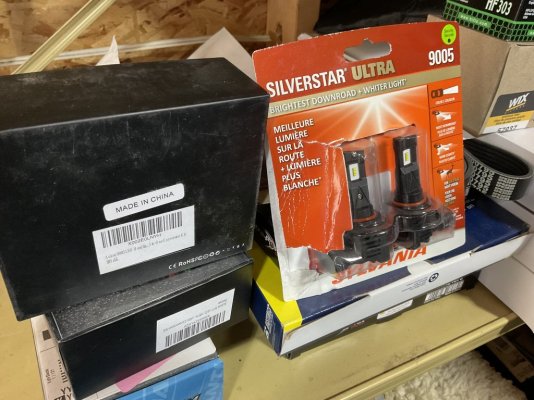

I agree that the OEM lights are dim. I only upgraded to Silverstar Ultra 9005, H11, and Longlife 4157NA. A few spare grill clips are good to have on hand also. The high beams are great but not the lows. I will move to the bulbs RamDiver suggested.

These are the LEDs that I used in my 2019 3500 tradesmen (H11 version) with great success. I also have them in my high beams of my current 1500 Warlock. The Silversucks ultra are in the low beam. I bought the Ultra while I was on a road trip, after driving through a rainstorm at night and not being able to see a damn thing, even road lines. Not the first time I’ve done work to a vehicle in the Canadian tire parking lot… probably won’t be the last either. The LEDs came out and went into the ultra package, where they reside to this day. I have not tried any other brand of LED bulb. I don’t feel that I will achieve good results with the OEM projectors without spending a lot of time and money, and a lot of trial and error.
