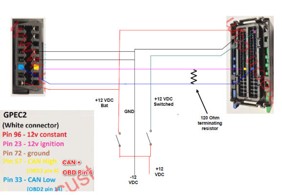

Bread boarding a project is just wiring it up loose to prove concept before mounting everything in a box, and wiring it all up nice and neat
C'mon now, you can't tease like that without posting a pic or two!!!! Haha, he beat me to it............

SUCCESS:
My homemade PCM tester is using the HPTuner to access / read the PCM. PS: This PCM is my locked OEM stock one that I saved away, just in case, not my unlocked one.
My spare DiabloSport Trinity 2 Platinum connects to it also with out a hitch.
