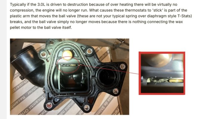

This is not a time bomb I would want in my truck. Rock Auto doesn’t have this type of replacement thermostat for any model of vehicle with the 3.0 engine. Nor can you buy a replacement cat from them.
I have not seen this engine in person so I can’t comment on how easy it would be to retrofit a conventional thermostat. Parts unobtanium is not a gamble for me. IMG_4079.jpeg
I have not seen this engine in person so I can’t comment on how easy it would be to retrofit a conventional thermostat. Parts unobtanium is not a gamble for me. View attachment 561458
I wouldn't class it as unusual to not be able to buy aftermarket parts in the 1st few years of a new model while the replacement of those components especially emissions related like a cat will be covered under warranty.......
Wow, you’re right even Rock Auto doesn’t have hardly any parts available except for a few filters and what not.
If these stick around, maybe the aftermarket will address those. Hi-flo cats are a pretty common thing for aftermarket support anyway.
I’m sure they will. One could always gut the stock thermostat and plumb a regular one in inline with a bleeder line.
