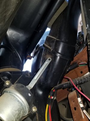

I have a 98 dogs ram 1500, The fan speed for the heater and AC only works on Hi, and the thing that controls what way it comes out whether it is through the front vents the defrost or the floor, does not work can anyone help me figure out what I can do here is what I found

The fan speed means your resistor is burned out. Cheap fix.
Defrost is a vacuum leak. Cheap fix with 3mm rubber tubing, but time consuming running it around the truck, from climate control to check valve, and beyond.
