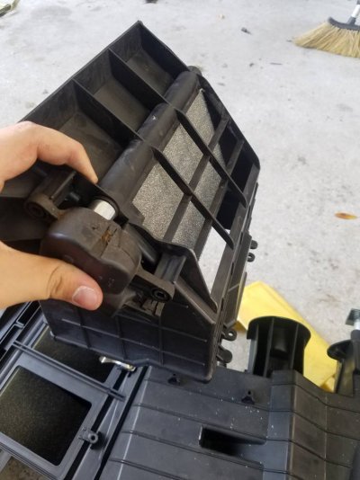

Yo, do these need to be installed? Seems like all they'll do is rub the foam off my brand new mode door... 11be074d17a946a77618d8aa39c28d28.jpg

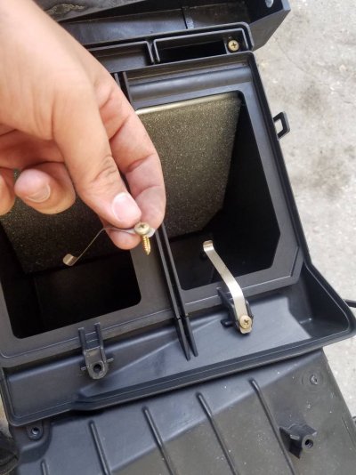

Also, it doesn't matter where the door sits in its range of motion when I reinstall everything right? This and others like it will be okay? ac44f43115d099a626d48cb06f966174.jpg
I reinstalled them. They won't hurt the foam and it doesn't really matter if they do. I put everything back the way i found it.
The motor will re-calibrate when it powers up from what I understand, so you should be fine with the door in that position.
