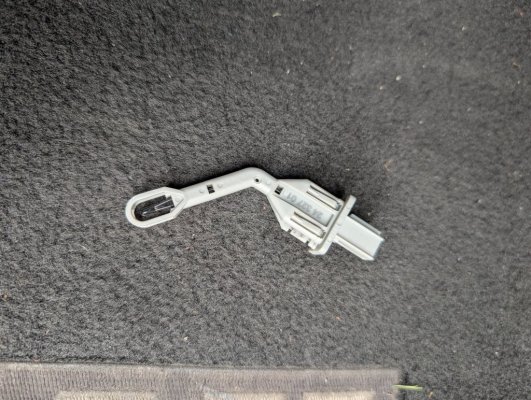

32
Brooklyn, NY
Anyone have one of these go bad ? I.just installed this while replacing my evaporator and heater core in the HVAC box. It's reading 21 ohms so almost a short. OBD2 reader showed code B1030-11 (short to ground)

Is that OEM or aftermarket?
I do OEM only for sensors. FCA / Rams don't like aftermarket.
It was the only one Rock Auto carries: STANDARD MOTOR PRODUCTS AX412.
And I hope the next one works because the replacement is also from the same manufacturer!
