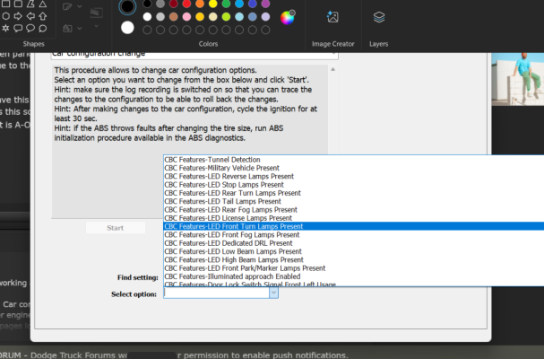

Those Harbor Freight ones are just read / reset. They won't change the program. You need a bidirectional OBD dongle like OBDLink MX+ (or equiv bidirectional) with the AlfaOBD program, or the big $$ dealer scan tools to make the changes in the program.
