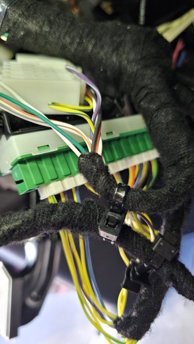

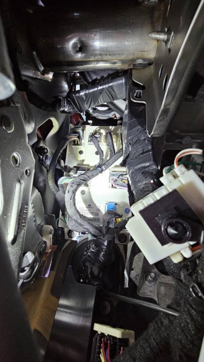

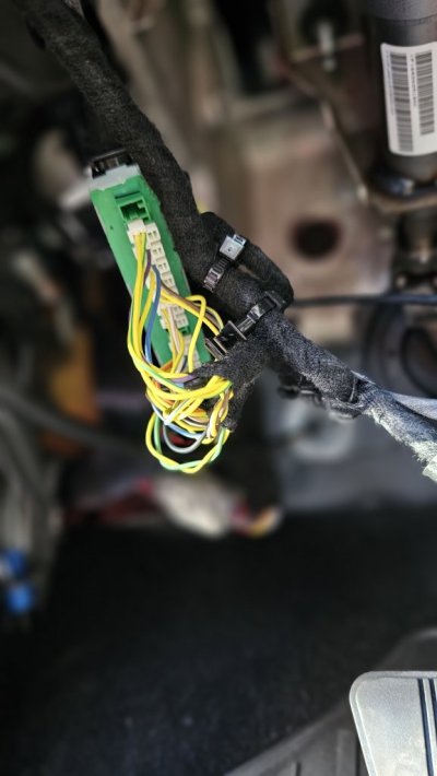

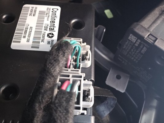

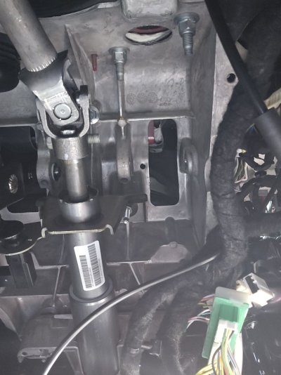

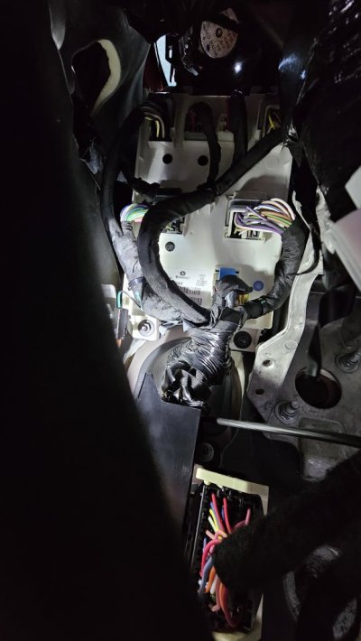

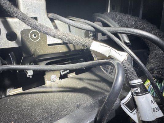

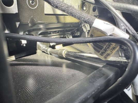

Hi, I need help! I can't find the security bypass on my 2023 ram 1500. I looked behind the radio, behind the cluster, under the driver's side dash and I couldn't find anything. I didn't see anything that looked like a module with 2 pigtails of wires. I only found the OBD module. If anyone can tell me where the famous security bypass is. I'll send you pictures to help you help me. Thank you very much for your help.OBD&light.jpgMAYBE Security gateway bypass.jpgMAYBE SecurityGatewayBypass 2.jpgMAYBE Security bypass 3.jpgMAYBE Security bypass 4.jpg20240530_134706.jpg20240526_133350.jpg20240526_133338.jpg

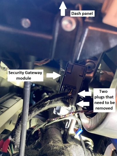

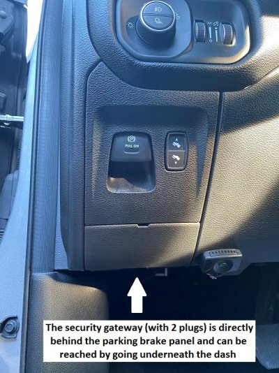

I thought behind the dash/instrument cluster was for 2500s.
Not sure how much changed with the uConnect5 upgrade but my 2019 1500 was under the driver's side of the dash, directly above the parking brake:
Security Gateway Bypass 1.jpg..............................Security Gateway Bypass 2.jpg
That is where I would install my Infotainment bypass:

Sound like you have a 23 ram classic in which case it is hidden behind the radio on a bracket thats a pita to get off but can be done with 7mm socket and the bottom screw you will also need a universal joint directly behind your 7mm socket.
SD28
Mar 3, 2025
NJ
2020 RAM 1500 Classic
Wow! After taking everything apart to check every possible location, I almost gave up until your post. Thanks
