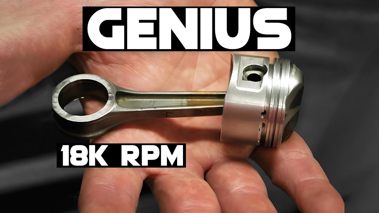

If you watch the video,the pistons are amazing for their size,torque was not a feature of these race bikes,lol

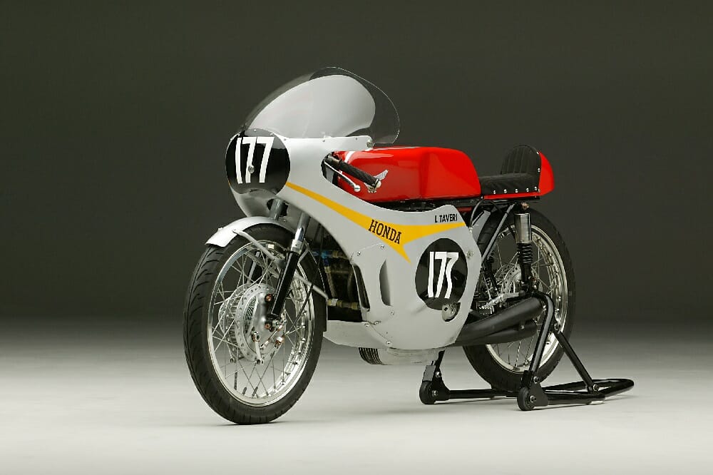

Honda built a "250cc" 6-cylinder motorcycle road racing machine, the legendary RC166, which was a dominant force in Grand Prix racing, particularly in the 1960s.
Here's a more detailed look:
  • The RC166:
    This motorcycle, powered by a DOHC 250cc six-cylinder engine, was a marvel of engineering and a key factor in Honda's early success in Grand Prix racing.
  • Mike Hailwood:
    The RC166, ridden by world champion Mike Hailwood, won eight straight 250cc Grand Prix races in 1966.
  • Sound and Performance:
    The engine's sound through six open pipes was legendary, and the bike was known for its high-revving capabilities.
  • Engineering Excellence:
    The RC166 was a testament to Honda's engineering prowess in the 1960s.
  • Piston Innovations:
    Piston axial length in Honda's early 1960s 250cc fours was 1.24 times bore diameter, giving them a “1940 Chevy” look.

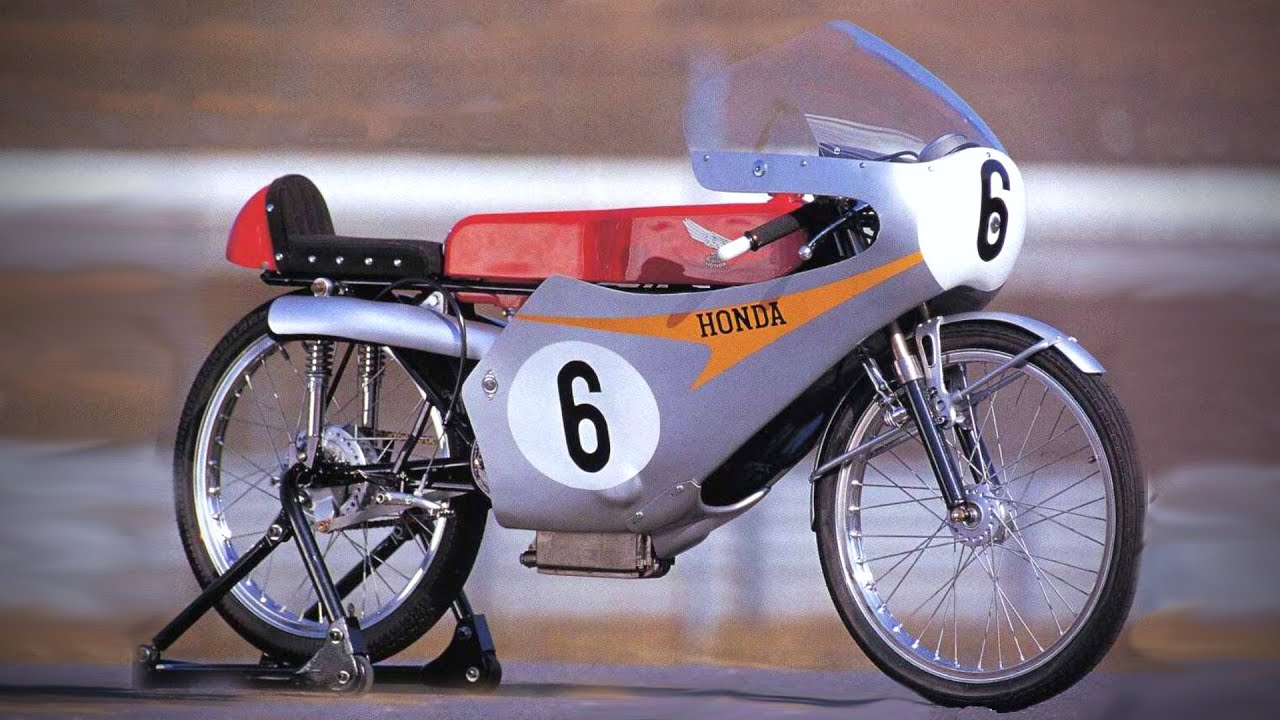

Honda built a 50cc, 2-cylinder road racing motorcycle, the Honda RC116, designed for the 50cc class of Grand Prix motorcycle racing in the 1966 season.
  • Model: Honda RC116
  • Engine: 49.77 cc, 4-stroke, DOHC parallel-twin, air-cooled
  • Purpose: Designed for the 50cc class of Grand Prix motorcycle racing
  • Year: 1966
  • Performance: The RC116 won three races from six during the 1966 season
  • Development: It was a development of the previous RC115 version
  • Notable features: The RC116 had cylinders the size of egg-cups, eight tiny valves, and revved to a giddy 22,500 rpm
This video shows the Honda RC116, a 50cc racebike from the 1960s:

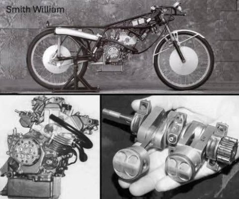

Honda did build a 50cc twin-cylinder road racing motorcycle, the RC115, which was a key part of their success in the smaller displacement racing categories in the early 1960s.
  • The RC115:
    This motorcycle was a 50cc racing machine designed specifically for the 50cc class, featuring a lightweight, compact frame and a high-revving, 2-stroke engine.
  • Early 1960s:
    The RC115 was introduced in the early 1960s and played a significant role in Honda's success in smaller displacement racing categories.
  • Twin Cylinder:
    The RC115 was a 50cc twin-cylinder motorcycle
  • High Performance:
    The RC115 was known for its impressive performance for its size, winning multiple championships.
  • Technology:
    Honda design engineer Shoichiro Irimajiri's masterpiece, the 50cc twin-cylinder, 21,500-rpm RC-115 put Honda in the vanguard of ICE technology.
  • Honda RC115 was a 50cc racing motorcycle introduced in the early 1960s. Designed specifically for the 50cc class, it featured a lightweight, compact frame and a high-revving, 2-stroke engine that delivered impressive performance for its size. The RC115 played a significant role in Honda's success in the smaller displacement racing categories, winning multiple championships. It showcased Honda's engineering prowess and commitment to dominating motorcycle racing, especially in the 50cc Grand Prix class. The bike's success helped establish Honda as a major player in global motorsport.
