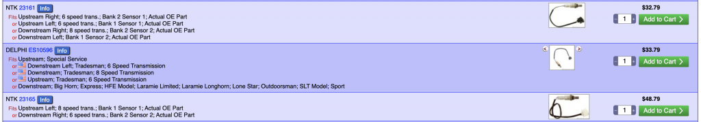

I've decided to change all 4 O2 sensors since I still got the same code again. If I get two of each NTks for upstream and downstream will they work just fine or should I get the Mopar ones instead? I'm only thinking to get these since I was told NTK are good OEM replacements and also one Mopar O2 sensor is almost the price of three of these sensors. I'd appreciate it if you guys let me know if these will be fine to use so I can order them asap. Thank you.

NTK & NGK is usually the MOPAR part, Mopar parts are usually which ever company makes it to Mopar Engineers Specs
here is the page from RockAuto, that covers your Ram
