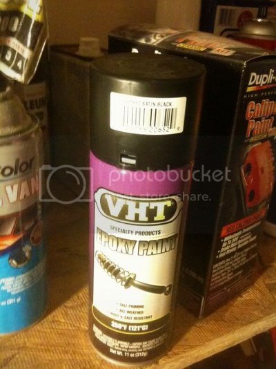

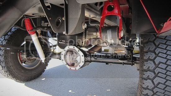

i used vht epoxy paint on mine. scuff with a red scotch brite, wash, dry and spray away. i used about 5 cans to do the entire underside but it was kinda windy out...
damn, it looks good!

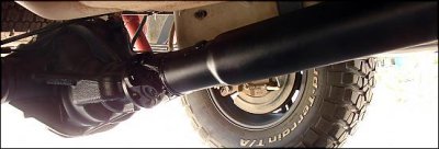

You should use rustoloeum paint. I use semi-flat paint. This is the closest I've found to 'stock'. Makes your truck underneath look amazing.
This is what I use and it looks fantastic!
