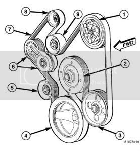

#4 is the one im taking about. So #4 is what make them all turn right?
1 - A/C COMPRESSOR OR IDLER PULLEY
2 - FAN DRIVE PULLEY
3 - POWER STEERING PUMP
4 - CRANKSHAFT PULLEY
5 - IDLER ASSEMBLY
6 - TENSIONER ASSEMBLY
7 - ACCESSORY DRIVE BELT
8 - GENERATOR
9 - IDLER PULLEY

#4 turns when the engine is on but not when it's off unless you put a bar on it and move it. That one is not your problem.
#5, & #9 are idlers. #6 provides the tension to insure the belt turns with the pulleys and I suspect that one is broke. Make sure the idler end of that tension assembly still pushes against the belt.

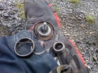

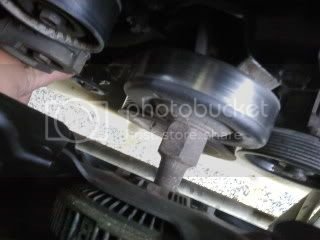

after getting a second look with a clear head this was what i found. What is left of the idler pulley.

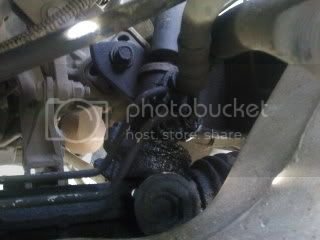

When i changed out the pulley i notice this hose inbetween the rack and front diff. It just goes up and has a cap/ vent on it. Any ideas where it goes. I think i need a new one.
Gonna need to replace my rack soon also. New about it for a while just bin putting it off cause its gonna be a ***** to do.

Is the hose attached to your axle? If so its supposed to be that way.
im not sure where it goes but its not supposed to be that way. the barb fitting is sticking thru the side of the hose and is broken. if it does go to my front diff im a little scared of whats gonna be in there after doing this.

Thats odd. I know I have a hose on my rear axle that is capped off and just kinda sits there, and I know the 4wd jeep I worked on had one on the front and rear, but if it doesn't look like the cap is supposed to be there then I'm not sure.
no im almost sure its factoy. just not sure where it goes. the top is fine its the bottom thats messed up.
