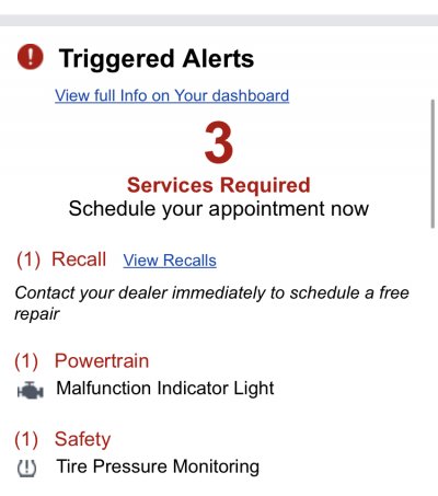

This may be unrelated, but Ive been receiving emails from Ram Service for the last week about “Powertrain MIL”

Get those Triggered alerts looked at, too many other things I could tell you but you must get a MIL, pull valve covers and check for rocker arm movement, 1or2 with little or no movement, that would be for a misfire.

MIL is malfunction indicator lamp , also referred to as CEL check engine light. There was a recall that involves replacing the cluster as it's unable to display the MIL, not sure if it's the same. There were also some recalls regarding the adjustable petal option. May ot apply to your truck, but in any case I'd ask if they've addressed all recalls.
