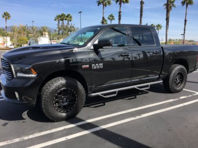

I've got 5100 front and rear with the fronts at 2.8" using Zone Off-road A Arms. In the rear I had Deaver do some custom 1.5" longer coils similar to the ones Icon makes. Before the rear was lifted the truck sat just a bit nose high.
2015 1500 4x4.

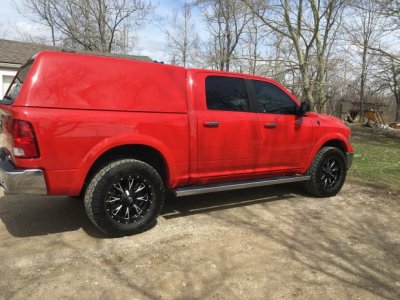

I put a set of airlift 5000 airbags in I believe you can run an inch higher with no issues. So far so good and the truck handles much better
What rims r those?
jrome
Mar 5, 2016
69
6
hemi
They are called fuel throttles. -12 offset. Im runnin 35 x 12.5 toyo extreme at
