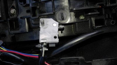

I have had terrible issues with my ignition switch lock not disengaging for quite a while now, i have been fed up with it for a while so i finally disassembled everything around the shifter to find the issue. well the issue is a very cheap microswitch installed that if moved in the slightest the wrong way it will not trigger the ground signal to unlock the ignition, so i removed and disassembled the switch but found no external issues, so i have put in a temporary solution to test for a while, if i have no issues, ill disassemble everything again to make a permanent solution.

Just an update, i have been running this temporary fix for a couple weeks with no issues, so i will be making it permanent as soon as i have the time.
