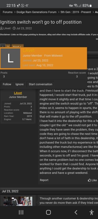

FYI, the OP hasn't been online since August of last year.
