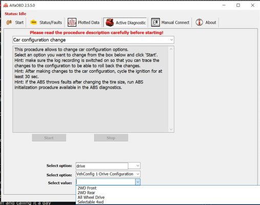

If you don't use it as a 4X4 you can delete everything ahead of the transfer case.Supposedly you can use AlphaOBD to reconfigure the truck to 2X4 and then you can unplug the front actuator.I pulled everything off my 4X4 long before AlphaOBD was around,so i just left the front actuator plugged in,i wrapped it up in a couple garbage bags and tied it up to the rack with some heavy duty zipties.
