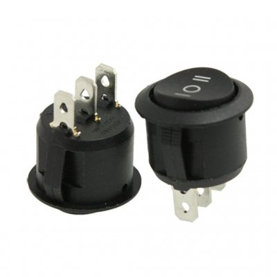

I have a 30" Rough Country dual row black series (NON-DRL) with supplied harness. I called & spoke with tech support & the dude said to wire this type of switch, I would cut the supplied switch, run the blue wire to the output of the new switch, white to input/constant on, & lastly, run a wire from the last available post on the new switch to the high beam wire, splicing it in.
Am I understanding correctly?:
- Spliced wire to high beam to top "I" post on switch
- Blue harness wire to center/middle "O" post on switch
- White harness wire to bottom "II" post on switch
