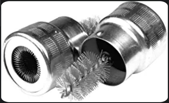

You can de-mystify the battery as a potential fault with a simple and low-cost digital multimeter.
They have endless uses for anyone but especially when they drive a rolling micro-computer.
As previously mentioned, a battery load test is always advisable whenever a potential battery fault is indicated. Most auto parts stores will perform a free test.
Another low-cost item to own is a battery post/clamp cleaner. They make regular cleaning easy and produce consistently great results.
When you pick up a post cleaner, get a small tube of dielectric grease. After cleaning both posts & clamps, just rub on a tiny amount to leave a small film of grease.
GTyankee
Nov 2, 2020
12,391
17,460
El Cajon Calif. 92021
3.0 ecodiesel
when he mentioned TINY AMOUNT
he means, an amount similar to how much LIP BALM, that you would use on your lips
