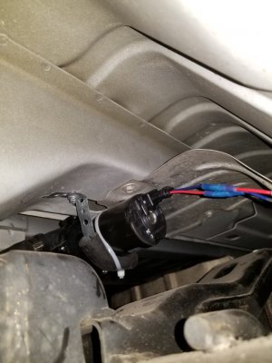

Do not assume a red wire is always the positive, for some reason the pigtail from the bosch cobra water pump they decided to put a blue and red wire on it. Sure enough I wired it assuming red was the + but in this case it was the negative, easy fix but I am sure this will be helpful the next guy. Got the Water to air intercooler hooked up, trying to get rid of them 180 degree inlet air temps, the Air to Air intercooler from procharger definitely could not keep up.
