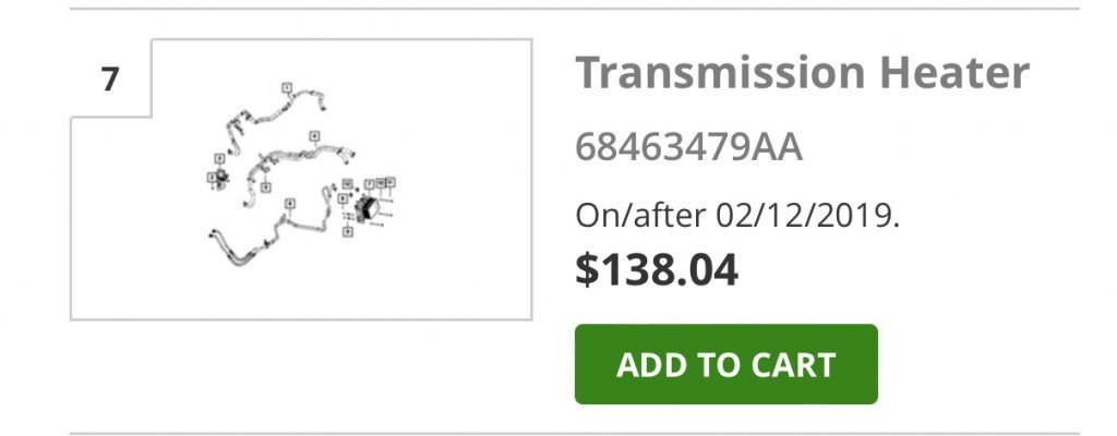

I’ll see if I can find the H/EX on my truck but if you look it is given to separate part numbers (Heater hoses)
If they were separate unassociated parts they would have different names and diagram listings (#4)
My understanding is the three-way heater valve was faulty and on recall and they didn’t have a replacement at the time.
The three-way valve was the source of the heat exchangers convection, correct ?
The heat exchanger part number shown in the diagram is only after 02/12/2019, other heat exchangers linked are for 6 speed transmissions.
Other opinions have complaints regarding the heat exchanger because the transmission generates heat on its own and because of its EPA designation.
https://revmaxconverters.com/produc...-8hp75-transmission-cooler-thermostat-bypass/
It could be just my misunderstanding that instead of not having a heat exchanger that I do not have a three-way valve present.
