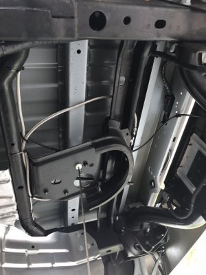

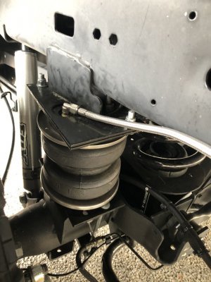

So after leveling the truck I’ve had a few heavy loads which definitely made the truck squat in the rear. I rectified that this weekend with the airlift kit with the added wireless controller.
So much nicer with the controller to make adjustments on the fly without needing a separate air source. Definitely solves the squat issue when hauling heavy loads.
I was planning on using the day star air bag cradles for when it goes off-road but it uses a single hole in the center where as the airlift kit uses two offset holes for mounting. After talking with airlift they claim there’s plenty of stretch in the bags to accommodate full droop of the suspension, just make sure to air it down to the lowest setting first.

Yea it came with the ultimate plus kit, it was the same price as the ultimate kit on amazon so no brainer for me. Still have to use the plastic line to tie it into the compressor though.

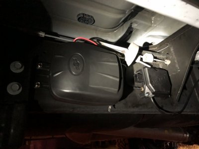

The bags themselves required no drilling. Mounting the compressor did require drilling pilot holes for the self tapping screws. It’s pretty thick so definitely use a good drill bit.

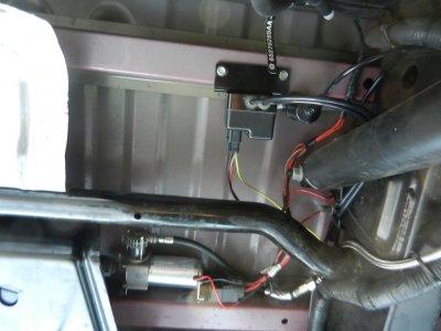

Great with the bags I just install the Airlift 5000 plus I install my wireless 72000 were you install your line on top of where the spare goes, and so far I'm loving them. I install my valve in the bed because I didn't want to drill no holes.

I had the wireless controller 72000 but I bought the airlift ultimate Plus off of Amazon for about $380 or something like that. Here is where I install my pump.DSCN3226.JPG DSCN3227.JPG DSCN3228.JPG
