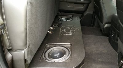

Installed some JL W1's and a JL XD600/1 using the factory sub wires i used speaker wire to rca's into the amp as a high input..

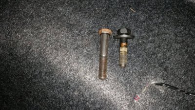

i ended up buying some bolts for the seats that are 3/4 longer then factory due to using 3/4 spacers ...a little pieace of mind knowing the bolts are in there good. i just used 2 washers and a nut for spacers giving me 3/4...
the factory bolts are M12 1.75 50.50 you can find 1/2 or 3/4 longer bolts.
i also install some JL 3.5 in the left and right and disconnected the center...sounds wayy better....and the JL Bass Knob
heres some pics...
