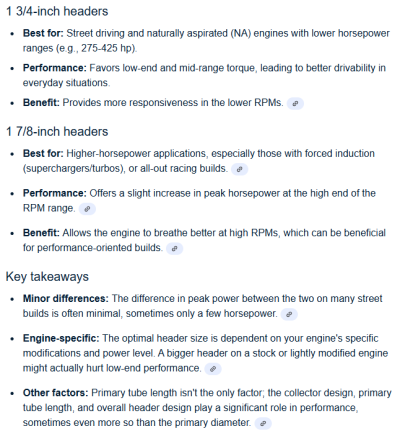

If going with LT's, here's some info to help you decide on sizing:
Personally, if staying NA engine and not going too crazy with the mods, I'd go 1 3/4, but that's me.

Unless you're going to do forced induction of some sort, I would do 1 3/4" headers. Additionally, since you want a nice sound, I would be sure to get equal-length (sometimes referred to as 'tuned') headers. Using tuned headers with an x-pipe and dual exhaust produces the sweetest exhaust note ever IMHO.

I have 1 3/4 “ ARH Longtubes , with the 6.4 intake and 6.4 injectors.
Be prepared for broken bolts.
Also installed a tru-trac with 4.56 gears .Due to the six speed.
I would keep the 1 3/4 “ unless planning on power adders.

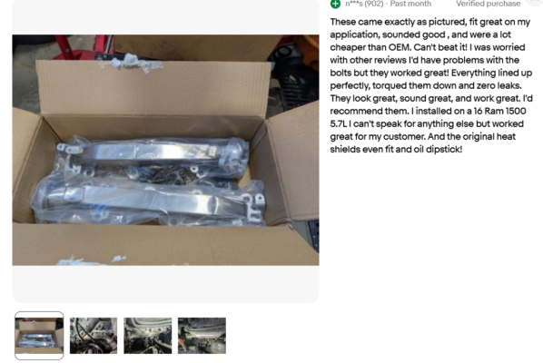

Check out Ebay headers,as the name brand headers are stupidly priced and aren't really much better then what you can buy off ebay.No way in hell should a set of headers cost $2500+.

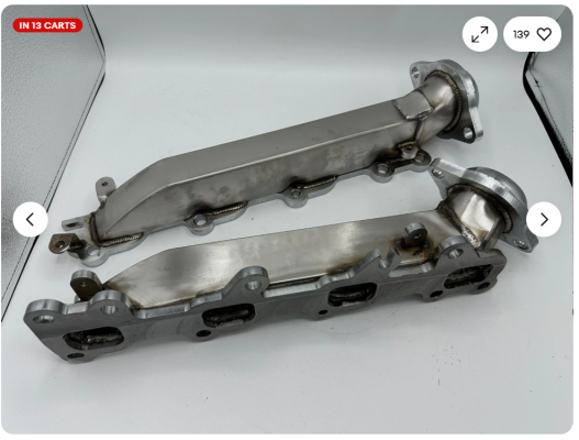

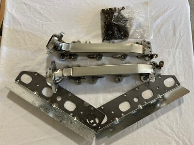

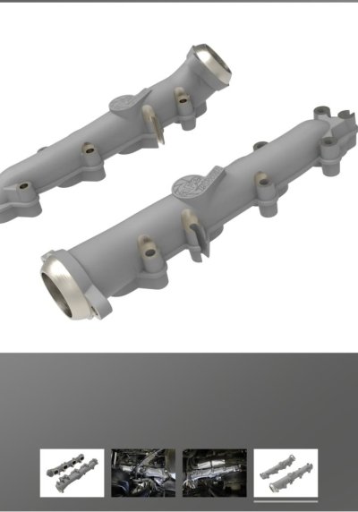

This is an interesting manifold design:
CanuckRam1313
Aug 29, 2022
3,273
8,068
Ontario Canada
2023 Warlock
Quite similar to the BD Diesel design except these are in SS.
Interesting indeed!

1 3/4" for a street truck vs drag truck.
