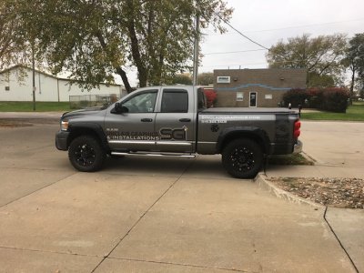

So I put a 2.5" leveling kit on the front when I added the 35" tires and 20" rims. There are apparently different tire pressure sensors because I keep getting the light to come on and flash 3 times every time I'm driving then it stays on. I thought these were self learning and would go off? I have aired up all the tires so not sure why it keeps coming on.
Also, I changed out the front struts(monroe all in ones)when I put the level kit on because they were under warranty anyway and had been leaking. Do I need a heavier duty strut to handle the bigger tires or anything else I need to beef up like the brakes or other suspension parts? Now that it's been done of course I'm asking.
Now that the front is lifted, the back end is sitting lower. I need to replace the back shocks anyway because they are worn out and was thinking of going with a Billstein or some other heavy duty shock that will lift it at least 2". Any good recommendations for this? Here are a couple pics of the truck currently.

I believe you need a block and not just longer shocks in the rear. I would consider dual steering stabilizer with 35" and bigger tires. Puts more stress on the steering components
