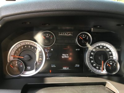

I just got my Cluster back from Dominic (great guy), he matched the miles on the premium cluster with the old one, the diffrence is night and day,makes my Tradesman feel more higher end.
Now on to install the leather steering wheel with audio controls...

Looks good. Is it true plug and play?
Yes, it is plug and play,
you will need to send the cluster out to have the milage and hours programmed from your old cluster to match.
if you have a 15' and up Ram you'll need a cluster from a 14-17' model because the 2013 models have a different tire monitoring system and if you have a 13" then only a 13 cluster will work.

You can also buy a cluster with more miles than your truck has and wait for your mileage to match and switch them then.

Do you have a link for Dominic?
Great mod. How much he charge you?I will like to do too the steering wheel mod. Can you explain to me what I need? Do I need to replace some wiring?
