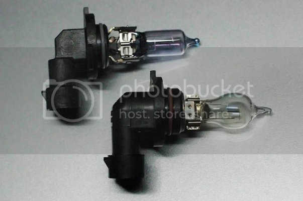

I installed the HIR1s inplace of the 9005s.
http://www.amazon.com/Philips-9011-...1?ie=UTF8&qid=1427166614&sr=8-1&keywords=Hir1
You have to modify one of the outside guides but they work great.
the 9011 is a 65watt also, not the standard 55w hi beam so it is brighter.
Dave
The 9005 is a 65w bulb, the standard low is 55w. The 9011 is a 9005 with different tabs, however the HIR1 (not a standard 9011) is a 65w bulb with a reflective coating and shaped bulb to reflect and emit more light
HIR1 (9011) vs Standard 9011
It sounds like you guys got the wrong 9011's
EDIT: apon doing more research it looks like things have changed over the years. The Toshiba HIR1 is no longer made, this was the globe looking bulb. From what I understand this "globe" paired with reflective material is what made it "infrared". I dont see this on the Philips 9011 which makes me wonder if it is in fact a HIR at all and they made it just because the base will fit the older application. I can tell you I have used the Toshibia HIR1's and they are much much brighter than any standard bulb. Im curious to see a side by side with the Philips 9005 and 9011. From what I see they should be identical, if the 9011 is still brighter than this is news to me, and excuse my ignorance :)
