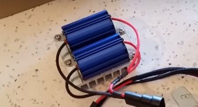

I stumbled upon a light vidoe on youtube that had heatsinks for the resistors, that looked smart. Do the models for the 2015+ have that from Retro Shop now to? Maby some upgrade for easy installation!??
I could not find any info on Retro Shops site, will order lights soon and may have to hunt heatsinks from some where els. Will order lights from you guy's ;)

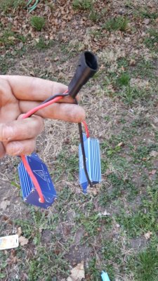

This thread needs an update. WTF does this connect to? There'
2 of them
