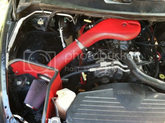

Okay guys, so I have been considering two options...
selling my K&N intake and getting a closed box intake..with some sort of ram air set up
or making my own box for the K&N
So..the things im wondering about..
I would probley use some kind of plexiglass/wood concoction..(more comfortable with carpentry then fiberglass work..)
do you think wood would hold up in a engine bay?
and then the K&N has the filter in the front passenger side of the bay, pretty far away from the stock air duct hole..should I try to tie into that stock hole or just rely on the ram air..?
heres a pic for reference..thanks for your commets and suggestions.

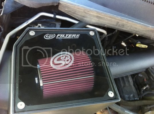

If you sell it and buy a different brand, I suggest S&B. It's got an enclosed filter and runs from the factory inlet instead of sucking in air from the engine bay
that's what I was planning on going with if it came down to selling and buying a new one, was trying to avoid
the hassle of selling though. I would rather build a box but I have those concerns I mentioned.

in the picture I posted you can kinda see it, it's on the passenger side above the fender well..on the pics of the s&b intake you can get an idea of where it plugs in
