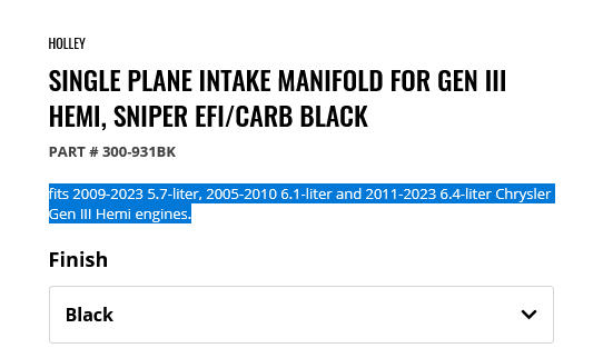

That's because someone didn't do the reading.....
Screenshot 2025-06-19 at 09-28-23 Holley 300-931BK Single plane intake manifold for Gen III He...png
This is from Holley's website by the way. Notice what isn't listed there? 03-08 heads are different (smaller & different shaped ports for starters) than the performance and later heads.

2003-2008 5.7. There is no 3G hemi prior to 2003.
OR
You can swap 6.1 or eagle 5.7 heads on to your block and then you can actually use this manifold. I assume this engine is not being used in the aforementioned truck because this manifold is terrible match not only to the stock heads and cam but for a ¾ ton truck.
