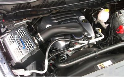

I went with a Volant unit,
Looks nice and has the 100,000 mile filter , also offers a scoop option although you have to buy it separate for like $ 100.00 bucks
I had a singel out the side but went with 14" magnaflow with custom stainless dual out the sides, sounds really good and only cost me $ 350.00 and everything is welded so don';t have to worry about leaks :)
