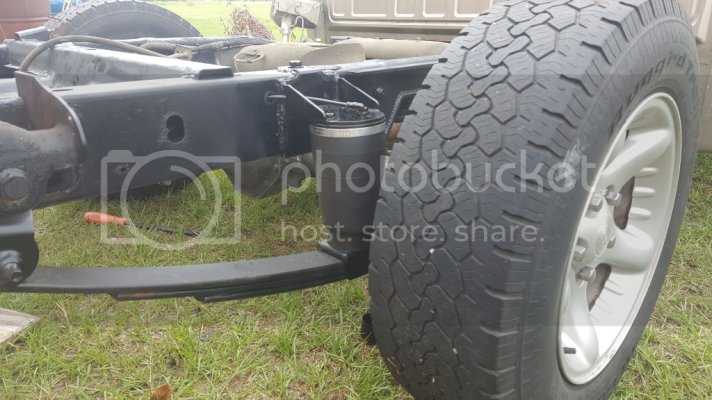

do you have a pic of the bag setup as well as the shackles?

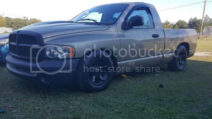

Nice looking truck you got there my friend.
Here's as close of a picture as I have. You really can't see the shackles, but they're shackles:
what shocks are you running?....I only run 40lbs or more when I have passengers or towing my boat...usually I run 15-20lbs when driving unloaded.
i'm running Belltech Street Performance shocks for 5" lowering along with relocation brackets.
