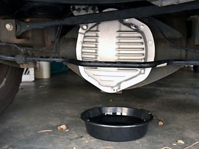

Sounds like a good test. never been done before. but you dont have to over fill them. and what i like about them is the drain plug. and not having to open up the diff to change to oil.

Interesting, looking forward to the results. I also like the convenience of draining and refilling with the covers.

No matter what the findings I’m still going to purchase & install the PML design.
Only 1/2qt more the Stock & the inside Shell is similar to stock design so refill will be right @ 4qts.
I’m mainly installing a new cover for the drain plug which makes for fast mess free service.
30 min tops & my AAM 11.5” is ready for the towing season.
It’s ridiculous AAM didn’t install a drain plug into the Differential Itself like ZF did with the 1500s.
