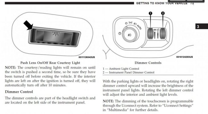

That lil center, call it a map light, on yer Tradesman should be on all the time the lights are on. There are (2) dials on the left side of the steering wheel: One is for interior lighting/evic screen brightness, etc and the other one controls the output of the "map" light.
Illuminated Entry
The courtesy lights will turn on when you use the key fob
to unlock the doors or open any door.
This feature also turns on the puddle lamps located beneath
the outside mirrors (if equipped).
The lights will fade to off after approximately 30 seconds,
or they will immediately fade to off once the ignition
switch is turned to ON/RUN from the OFF position.
The front courtesy overhead console and door courtesy
lights will not turn off if the Illuminated Entry ON button
on the overhead console is pushed.
The illuminated entry system will not operate if the
Illuminated Entry OFF button on the overhead console is
pushed.
NOTE: If your vehicle is equipped with Illuminated Approach
lights under the outside mirrors, they can also be
turned off by pushing the Illuminated Entry OFF button.
