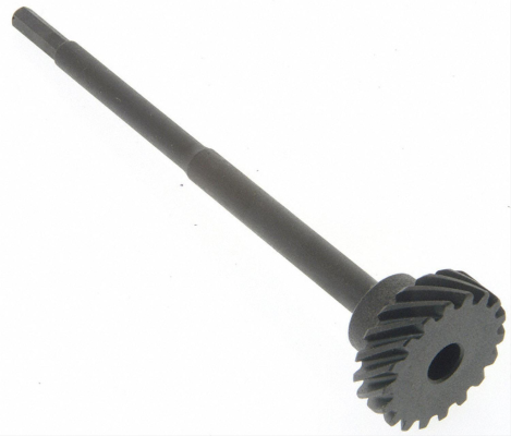

Getting ready to freshen up the front end of my 2013 ram 1500 4x4. Pretty much replacing everything. My truck has 3.92s and everything I’ve seen rockauto for intermediate shafts is stating 3.55 but was told by a buddy they will work with either. But before ordering both sides and bearings I figured I’d ask here first and if what he stated isn’t correct where could I find the correct ones to order thanks!

Yep. I emailed a company with the same scenario. They replied that it doesn't matter what the rear end is. The same product will fit all gear ratios.

Can't say as i've ever heard an oil pump drive,ever called an intermediate shaft,must be a Yankee thing :Big Laugh:
Very well possibly
Look up Mopar P3690875 on the interwebs and half of the results call it an oil pump drive, the other a intermediate shaft

Every place I search for the parts call them intermediate shafts so that’s what I went with calling it. Went ahead and ordered both sides with bearings for I have more play then excepted and slight vibration coming from them.
